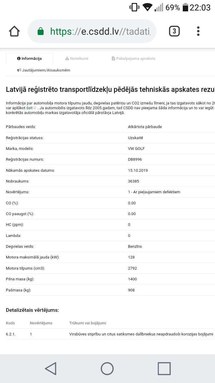

Post by mikimiki » 15.10.2018, 17:13
Ar snipping tool apgraizīju shēmas no drive. by etkas
