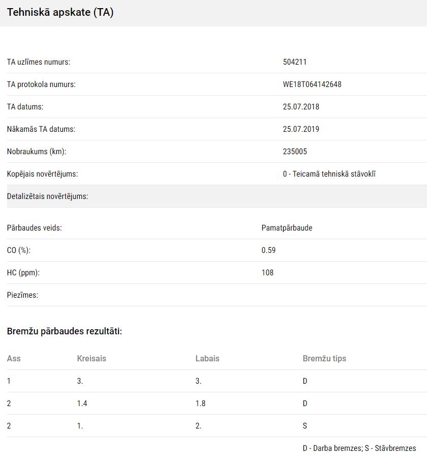

Post by Jujubokar » 25.07.2018, 14:52
Karljiks3
Posts: 576
Joined: 02.02.2013, 14:47
VW: mk2 jetta coupe
Location: Rīga, Latvija
Been thanked: 20 times
Re: Jujubokar's MK4
Post by Karljiks3 » 25.07.2018, 15:03
Uzpirkts inspektors, kas veica pārbaudi. :lachtot:
