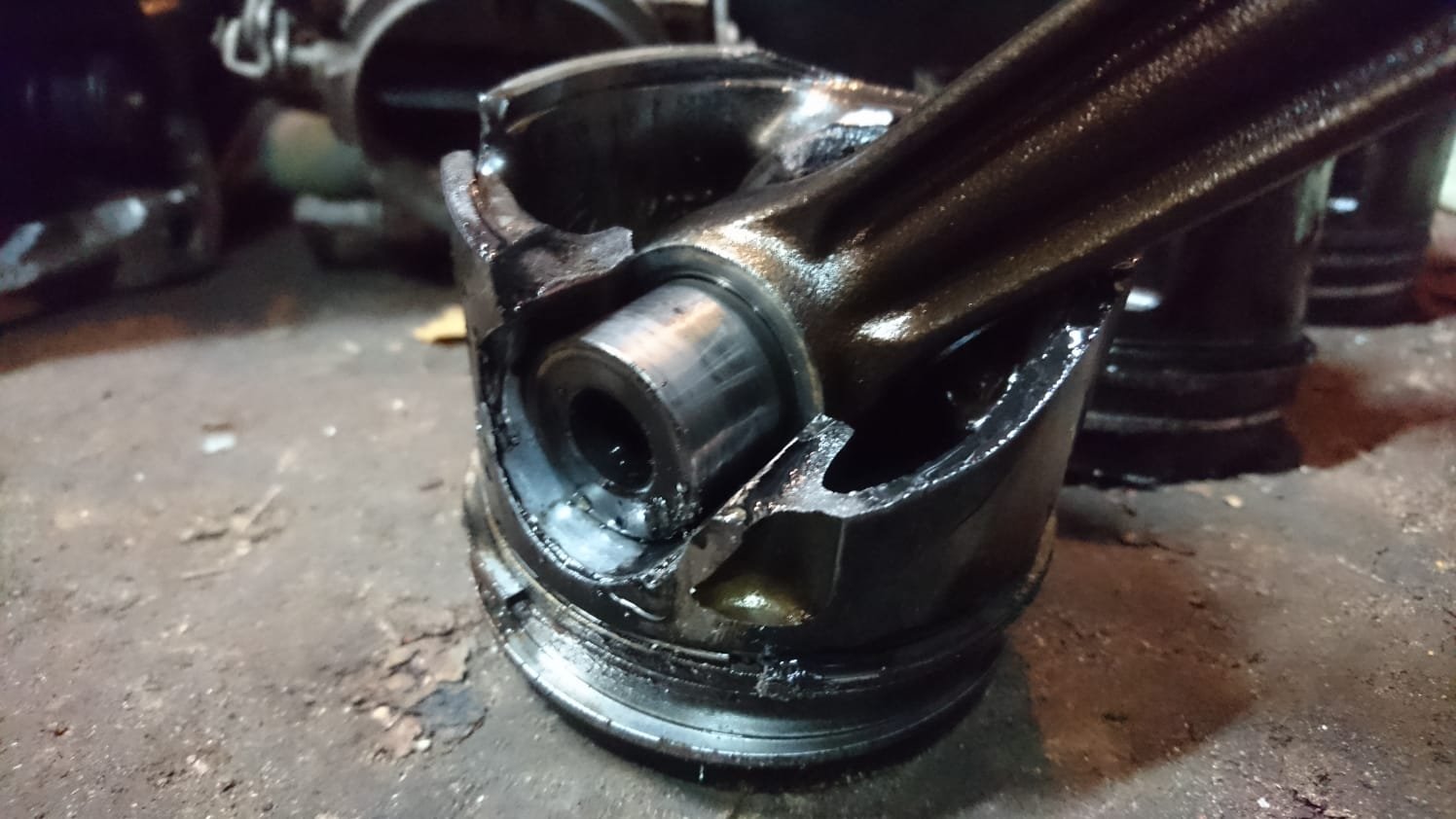

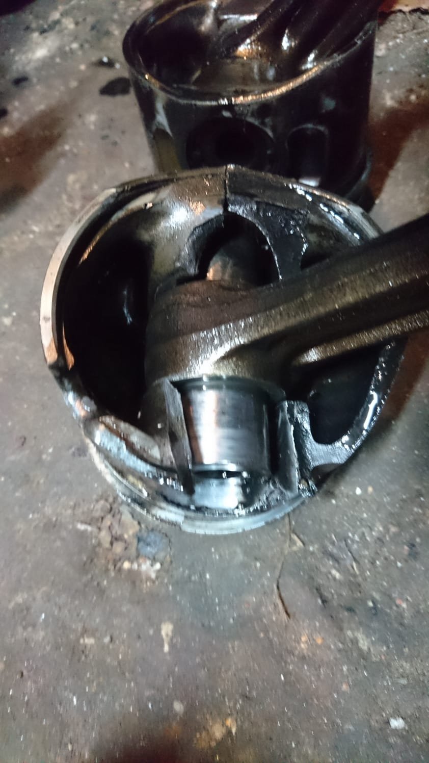

Re: msh mk2 golfmašīna jebšu DIVLITRIS
Rekur musu evakuatora graboņas iemesl,nobraucam ar tadu 1000+km
- Attachments
- IMG-20190220-WA0034.jpg (128.83 KiB) Viewed 1894 times
- IMG-20190220-WA0035.jpg (138.83 KiB) Viewed 1894 times
